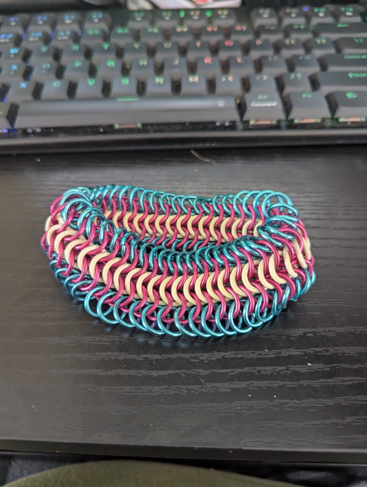

I took a break from trying to figure out Moorish Rose to make a couple bracelets for family and play with Rubber rings (the white is rubber and just stretchy enough to not need a clasp)
ChaoticUnreal
Ars Tribunus Angusticlavius
7,873
So I ended up giving up on moorish rose while it looks amazing I just couldn't get it to work.
Ended up using Japanese 12 in 2 for the shell/head, full Persian for around the shell, and then scale for the flippers and tail. I think it turned out pretty well. Not 100% in love with the head (I think it looks goofy) but I can't think of a better way to make the head or how to fix it.
ChaoticUnreal
7,873
Damn man, how long does it take to do those things? It must be a lot of time.
I normally do them when stuck on work meetings ;-)
If I had to guess probably like an hour or 2 for a pair. If I have the design in place I can do it with all the little rings closed which makes it much faster.

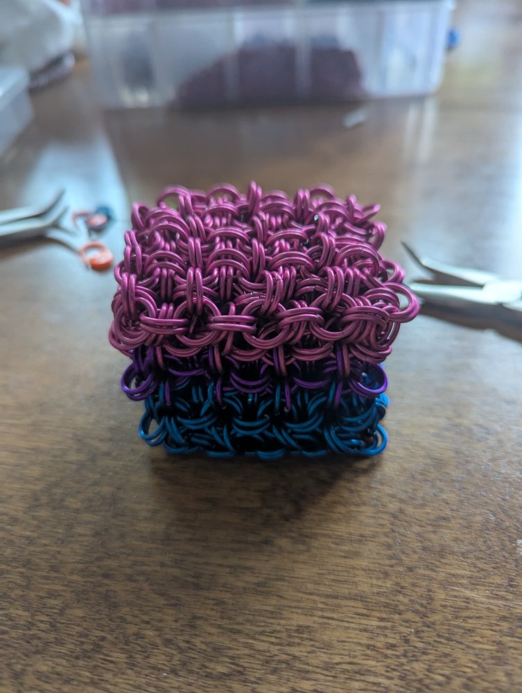

Over the weekend I made myself a new fidgit / paper weight. It is a 5x5x5 jelly cube.
Been awhile since I made a jelly cube so took a bit to get started (I had made my kids 3x3x3 ones when I first started doing chainmail)
I don't think I'd make another one that large since it takes a ton of links (over 1000 total) and with no real use for it.
