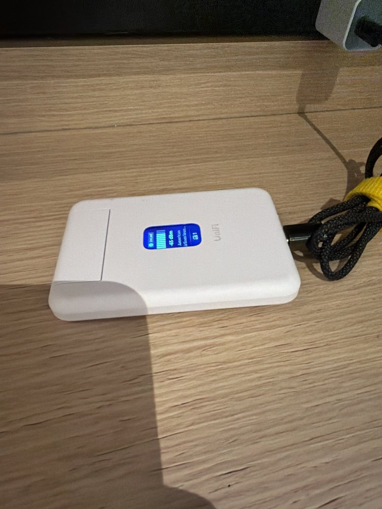

I received my UniFi Travel Router. I paired it with a small 10,00 MAH power bank.
Set up is extremely easy and straightforward using the Unifi app I already had on my phone.
It asked which console to use as its settings source and happily grabbed the info from my UDM Pro and created the main SSID I use after asking which one to use.
It will only broadcast one SSID at a time.
I fly out Thursday on American Airlines, and will test it out in the Admirals Club Lounge and on the flight.

Currently in the AA Admirals Club lounge using my UTR.
It was a little impatient connecting to the free lounge WiFi but worked with only a few additional clicks.
Teleported just fine back home to my UDM Pro.
Edit: this is working seamlessly.

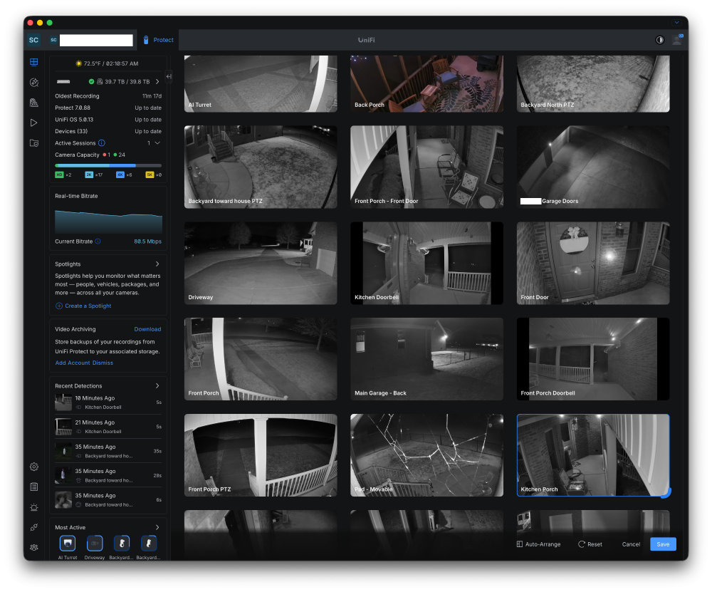

Hap
Ars Legatus Legionis
12,123
Yeah for UniFi, there isn't much difference other than form factor, I have a wide swath of UniFi cameras and I honestly can't tell the difference between dome/turret. They do have PTZ, but you have to really step up and they are huge. They do have a fisheye or two in a dome form factor.
Why so many? it's a mix of my wife wanting full window coverage and a friend that installs these as a side business and we use my house (external) as a testbed. The internal is all about the shops, particularly about keeping an eye on the lasers if they are running.
Teleported just fine back home to my UDM Pro. View attachment 130938
Looks like they just made a very old consumer product of theirs from the Amplifi brand they killed into the Unifi eco system.
To the best of your knowledge are you able to assign static "Local" ip addresses via DHCP though the VPN it creates?
Not that i'm on Unifi anymore, this is more of a curiosity.
